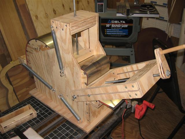

I've been reading the other recent post on bending venetian cutaways and I still can't get good results so I wanted to ask a few more questions.
I've been trying to get to where I can bend cutaways in my shop made fox style side bender. I have bent them on a hot pipe before with EIR but I had a hard time with that, so koa on the pipe is out of the question.
Today I tried a test with some scrap mahogany thinned to .080(should be thin enough for mahogany). I wetted the wood and wrapped it in aluminum foil (because my test without it also failed). I got the temperature up to 250 degrees. I bent the waist first and then the cutaway part. I don't know whats wrong but I can't bend it for nothing. I always hear it breaking and I don't even have to finish the bending. I'm hoping maybe someone can suggest something that could be causing the problem. My problems are not as much on the horn of the cutaway as in the deep curve of the cutaway. Instead of bending it will just break right in the middle.
Could my wood be drying out too fast? It takes a couple minutes to clamp the waist all the way down. Maybe by the time I get to the cutaway it is too dry? Usually when I know I've broken it I will shut off the heat blanket let it cool to where I can handle it and take it out, it is usually bone dry at this time. Shouldn't it still be damp since it did not cook in the bender?
Could my cutaway pressing block be the problem? I've noticed some machines have a piece of pipe right there that looks like it rolls.
Does anybody use the stainless steel slats from LMI for cutaways? They seem almost to stiff. They also do not spring back very flat.
Any info would be appreciated.

Maybe my thermometer is not giving a good reading because I bend the waist and lower at 150 and with it on full blast by the time I get to the cutaway it is a 250 and it almost seems to stop there. I was just re-reading the bending instructions on John's site and I noticed he said to insert it in the sandwich. I had just been setting the tip of it on top!
So, when your waist is clamped half way, you just open the cutaway part of your sandwich and spray water right on the craft paper wrapped wood to re-wet it?
What is the cutaway ram on your machine like? Pipe, block?
Brock,
I do put clamps on the slats as they are heating.

Colby, as Michael said, your temp is quite low. If you put the probe of the thermometer (assuming you are using some sort of meat thermometer) right next to the blanket in the sandwich you'll have pretty accurate results.
Is your cutaway tower flexible? Meaning will it pivot on the attachment blot? As you bend, you'll want to very firmly hold it "up" toward the waist to keep everything tight. That's important. Otherwise an option is to pull the slats "outward" away from the waist as you are cranking the cutaway tower. But that turns into a two person job pretty quickly.
Good luck. Paul
